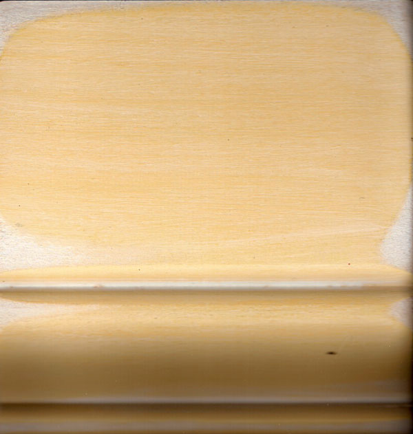

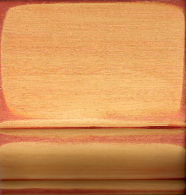

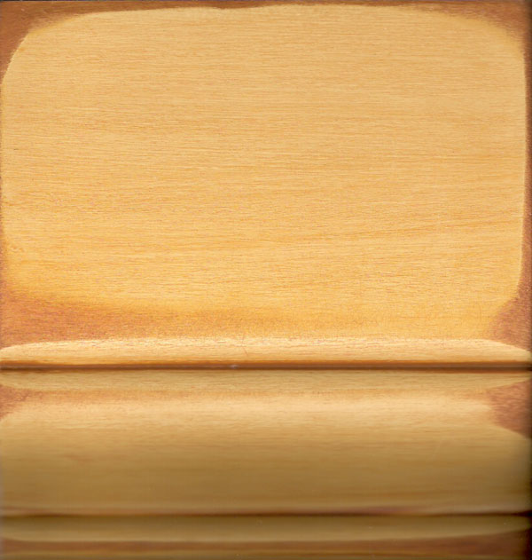

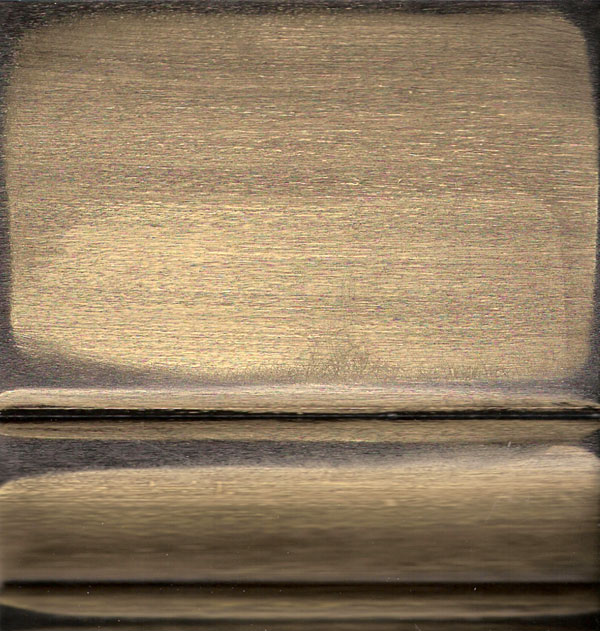

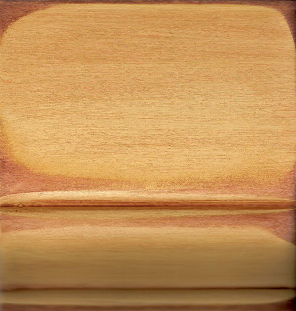

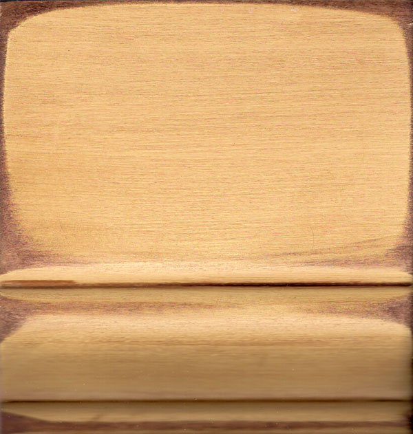

Applying General Finishes Glazes
Glaze Effects are translucent water-based colors that may be used over any water-based stain or paint to create beautiful decorative finishes such as distressing, antiquing, burnishing, and color washing.
- Always test the color on the underside of the project. It is your responsibility to insure that the color is what you want. Do not practice on your new furniture!
- Always stir the contents well. Stirring distributes pigments that have settled to the bottom of the can.
- Option: Before applying glaze you have the option of top coating first, which will help you control the amount of color and facilitate the spreading of glaze over the surface. The Top Coat layer is smoother and less absorbent, allowing the glaze to slide across the surface. If you want a rustic look with more color, skip the Top Coat layer and apply the glaze directly to the paint. Start with two base coats of Milk Paint following application instructions shown above.
- Let the final base coat dry for 2-3 hours.
- Pour Glaze color into a paper plate covered with aluminum foil or painter's tray. Working one small section at a time, apply the Glaze liberally with a foam brush, synthetic brush, or paint pad over an entire section, keeping the surface wet with Glaze.
- Wipe off excess with absorbent wiping cloths or paper towels to achieve the desired look. Do not use Tee-shirts.
- If you want to rework a section, simply rewet the surface with Glaze.
- Work quickly, so that the Glaze color does not dry before finishing a section. If necessary, mask off smaller sections around raised areas such as beadboard and moldings. Glazes dry fairly quickly, so plan your sections before beginning.
- If working in high temperatures or low humidity, Glaze Effects may be thinned with 10-20% water or General Finishes Extender (3 to 6 oz. per quart) to improve open time for application.
- Let dry 2-4 hours. Apply water-based Top Coat for additional durability or to increase sheen.
